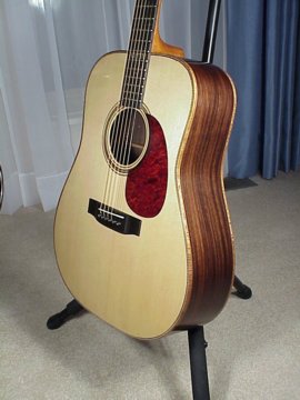

Well, here it is.
I/(we , thanks to all the great info on this forum) built this from an LMI kit (with some minor mods).
I'm happy with everything but the action.
It seems something changed from the time I checked the neck position and the time I actually clued it on.
It has what I would consider a medium action.
The problem is, I've run out of saddle to whittle on.
Any suggestions?

Looks great! Congrats...
PostPosted: Tue May 09, 2006 9:39 am
Posts: 4817
It does look great!
PostPosted: Tue May 09, 2006 9:40 am
Mike, it looks very nice and a real nice finish you got there!
If you ran out of saddle the only way maybe be a neck reset
But, let the pros chime in! There's tons of help at the OLF!

Hi Mike, It looks great . Nice tidy work . Something to be really proud of . Bet it sounds fantastic too !
I can only see a neck reset .Corrogated cardboard all round the fingerboard to isolate the heat you will need to loosen the glue.
My advice would be to reset the neck and not glue down the fingerboard until the guitar has finally settled (action wise )
Great effort Mike
Regards KiwiCraig

Nice work. I really like the headstock. As far as action, check the neck relief first then consider a reset if still too high. Shaving the bridge may be acceptable for a short term fix, but it's really not the way to go. BTW it looks a lot better than my first.
PostPosted: Tue May 09, 2006 2:25 pm
Very Nice for a 1st. VERY VERY NICE
You will want to reset the neck. Experience will help over time.
The goal is for low action with a taller saddle. This will give you many years
with a lot of room to work with. Now with CF rods and better neck joints,
neck resets will be needed less often.
John Mayes video shows a good method for setting the neck. Worth the
purchase.
PostPosted: Tue May 09, 2006 3:34 pm
Very nice first guitar Mike.I agree with the others,it sounds like you need to reset your neck and make a new saddle. Good job!DaveAndy38847.0253472222
PostPosted: Tue May 09, 2006 3:48 pm
Joined: Sun Oct 09, 2005 4:25 am
Posts: 24
Thanks for the encouragement and replies.
The finish is nitro, 3-4 coats a day. Let sit overnight. Wet sand with 600 (usually takes off about half the finish to get flat). I did this 3 or 4 times until it was good and flat and I felt like there were 6-8 coats of finish left. Then I sanded to 2000 grit and waxed with a good carnuba wax.
Resetting the neck is not what I wanted to hear, but is what I expected .
I glued the entire surface between the fret board and the top!
Will I need to pull the 15th thru 20th frets before heating the fret board extension to soften the glue joint?
Any hints/clues on how to remove the neck with the least amount of damage would be greatly appreciated.
